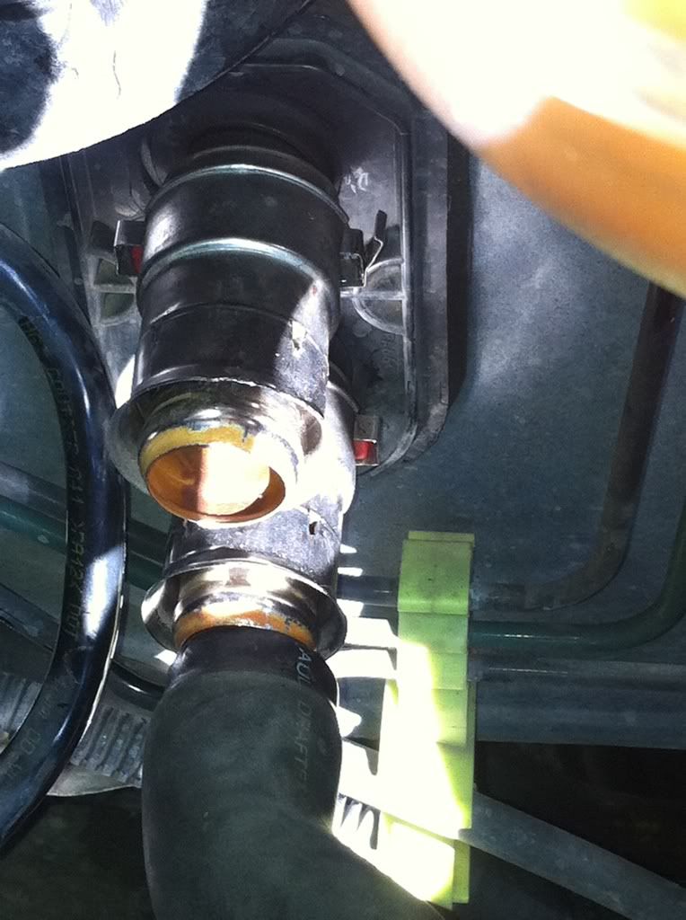

I have been trying to remove the two locking sleeves that secure the hoses that enter/leave the heater matrix. The car is a 1999 1.4 8v clio.
See here -
I have been pressing in the buttons on either side and they're not moving. Does anyone have any suggestions?

Well today I showed the locking sleeves who was boss, but it wasn't bloody easy. Even with a pair of molegrips clamped on pressing the release tabs in they wouldn't move. So I had to painstakingly remove them with tin snips, a hacksaw, pliers and a huge amount of patience. The new heater hoses are of a much better design, made from plastic and easy to release. However after flushing and refilling the coolant system the heaters are only blowing warm, the engine gets nice and hot and registers the correct engine temperature on the dial. So I can only assume that there is an air lock in the heater matrix somewhere, I think tomorrow I'll jack the front of the car up and rebleed it.
Does this sound like a logical assumption?
