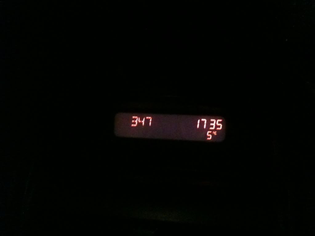

How do i take out the radio display in a 2002 Clio 1.2 16v so i can change the bulbs at the back, its very dim and hard to read.

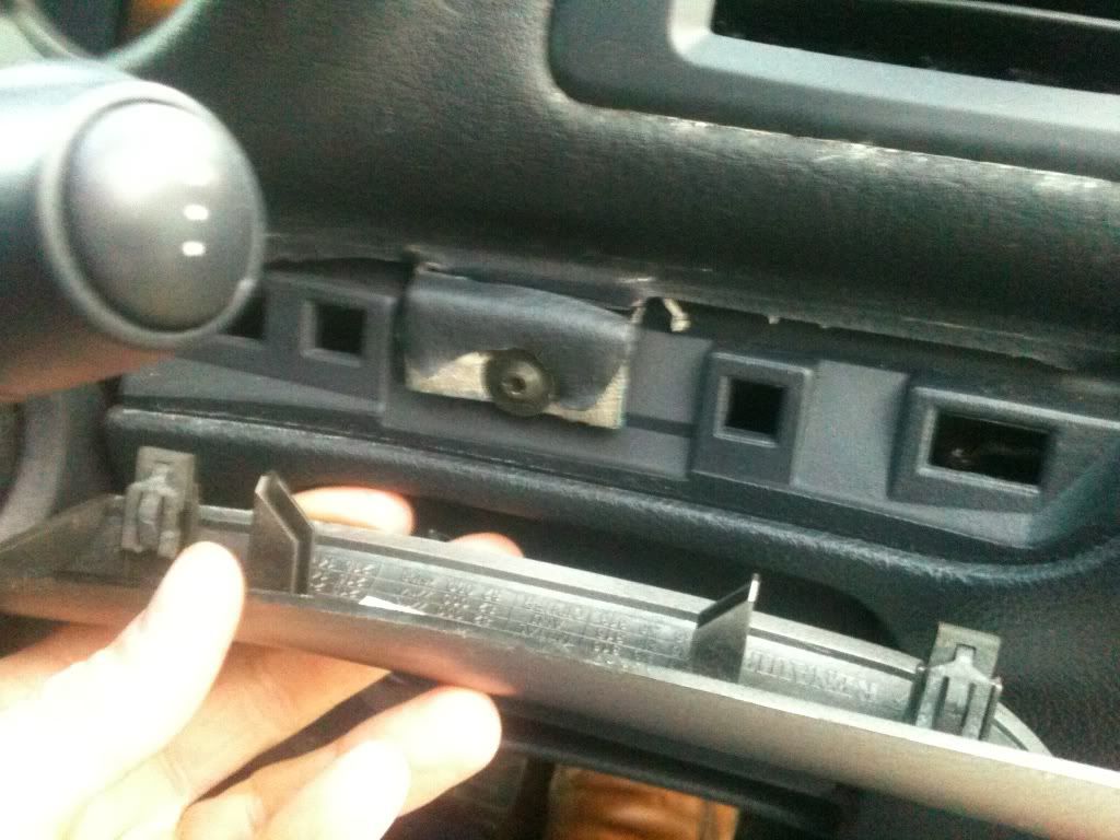

I had a practice at the breakers yard on a clio so i was able to get at the bulbs for the lcd display on my own today. Its quite a long process considering its just a bulb. I took pictures of how it was done.

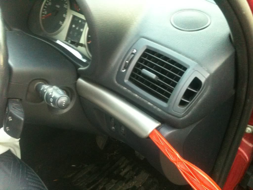

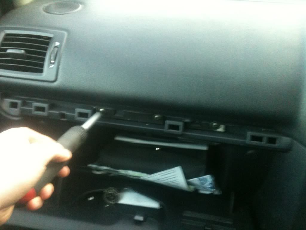

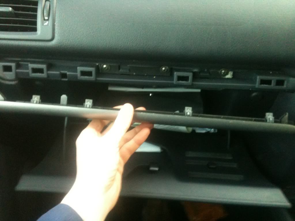

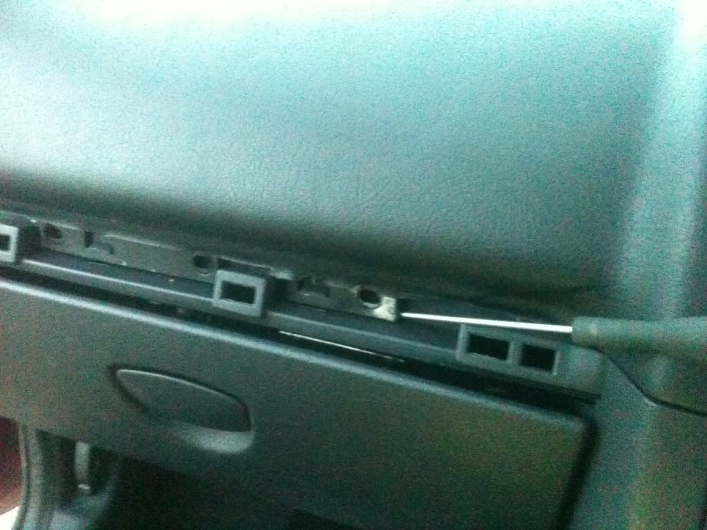

The first thing to do is to pry off the trim above the glove box lid, screwdrivers work, but since the plastic isn't very strong id advise using plastic pry tools:

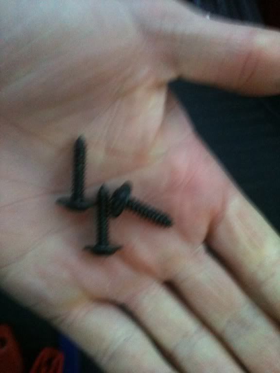

under that there is 3 torx bolts which need to come off:

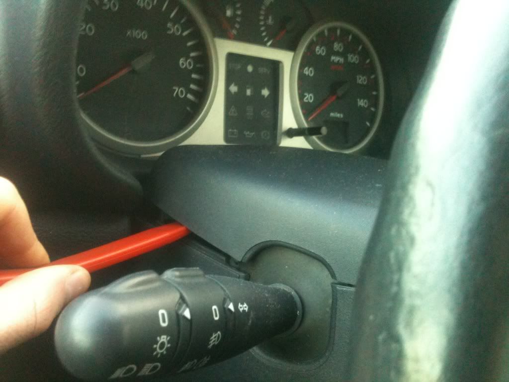

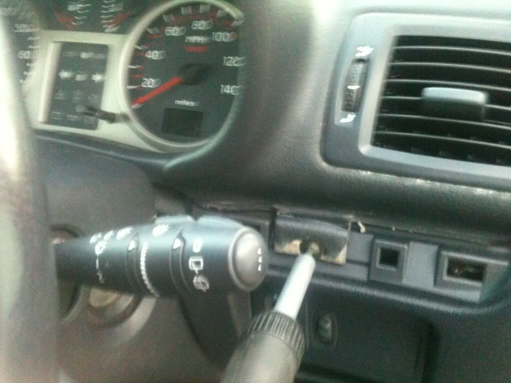

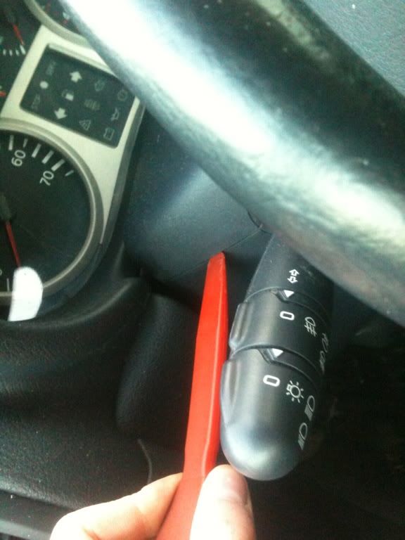

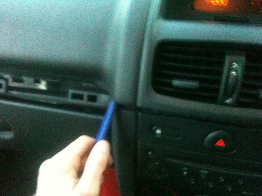

There is another bit of trim on the drivers side which needs pryed off:
and one torx bolt:

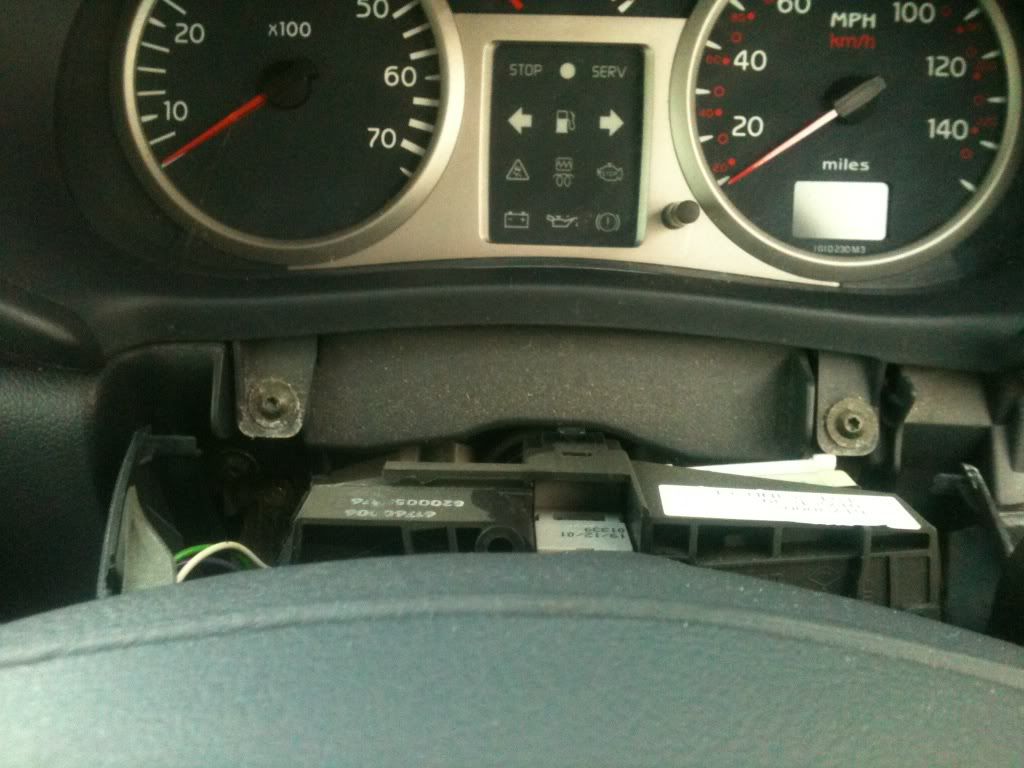

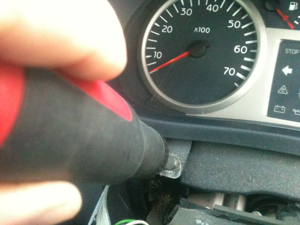

with that done there is a pair of torx bolts at the bottom of the speedometer, but i couldn't get anything in to remove them so the steering wheel surround need to come off, its just clipped into place, so pry it off to reveal the bolts:

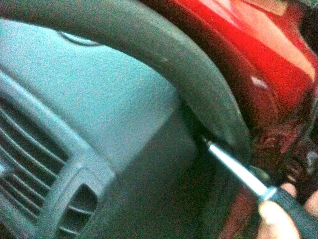

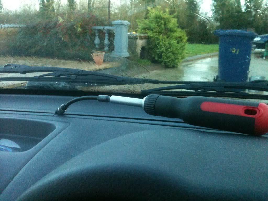

Then there is 3 torx screws at the front of the dash by the windscreen, a flexible screwdriver attachment is good for removing them:
they are slightly smaller than the other torx bolts:

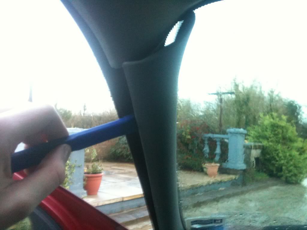

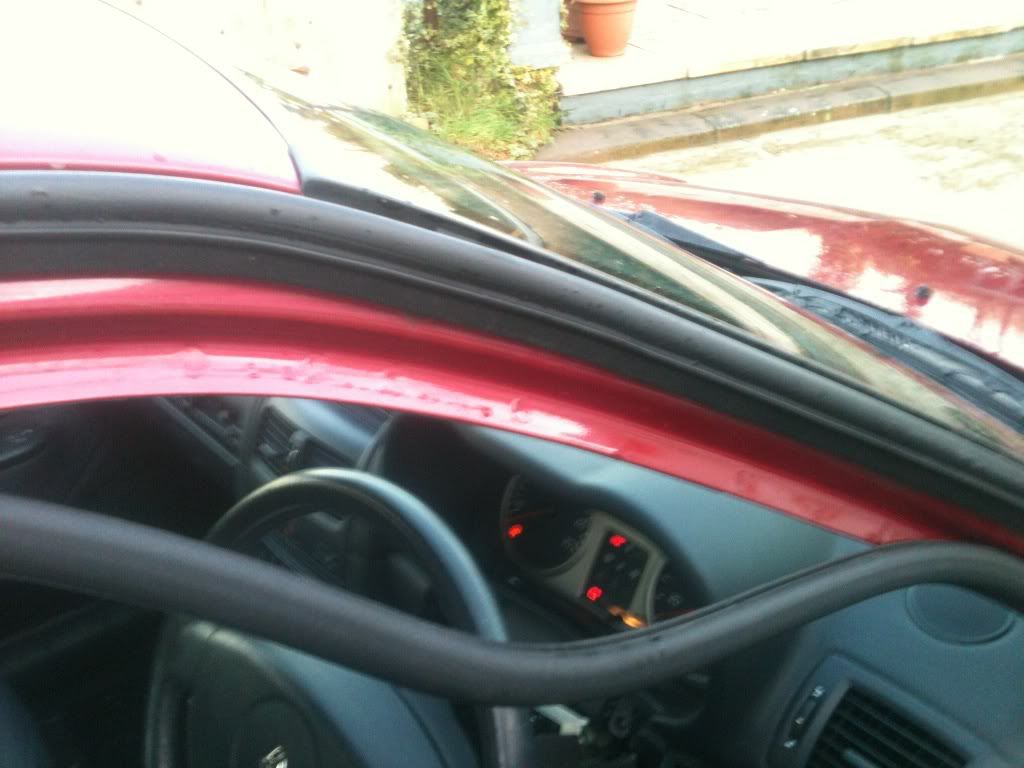

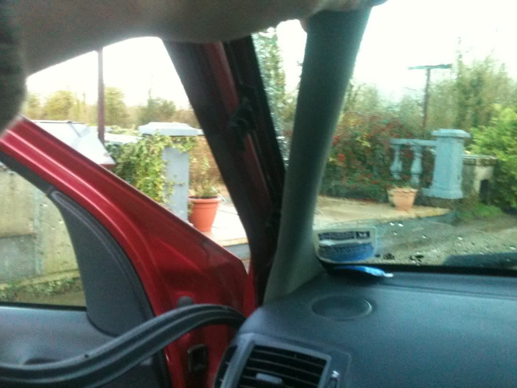

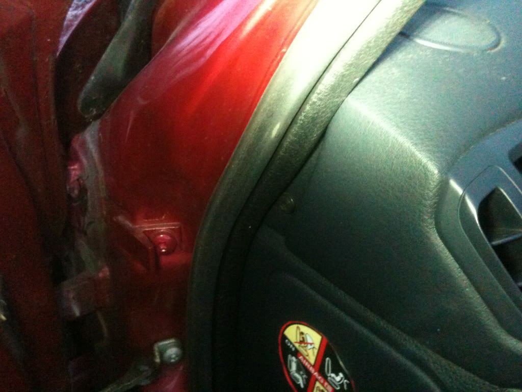

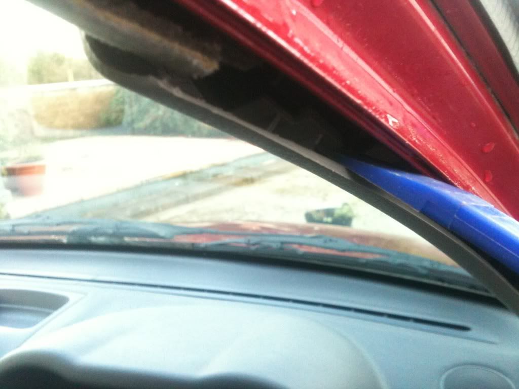

the A pillar trims looked like they were sitting in the way so they came out, it helps to pull the seals out first before prying at them, i found prying the top and then pressing in on the clip is the best way to remove them, there is another 2 clips further down but the top one needs released:

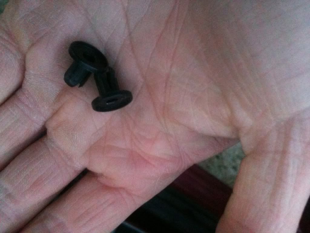

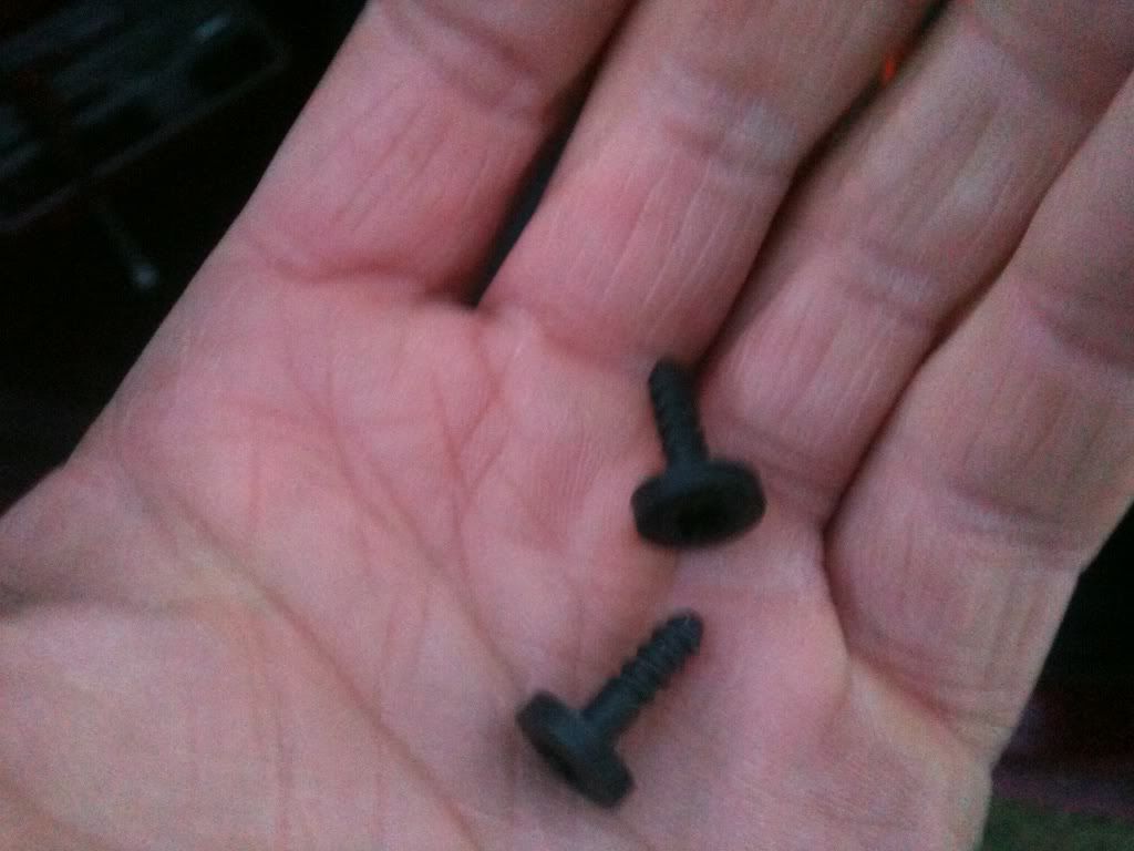

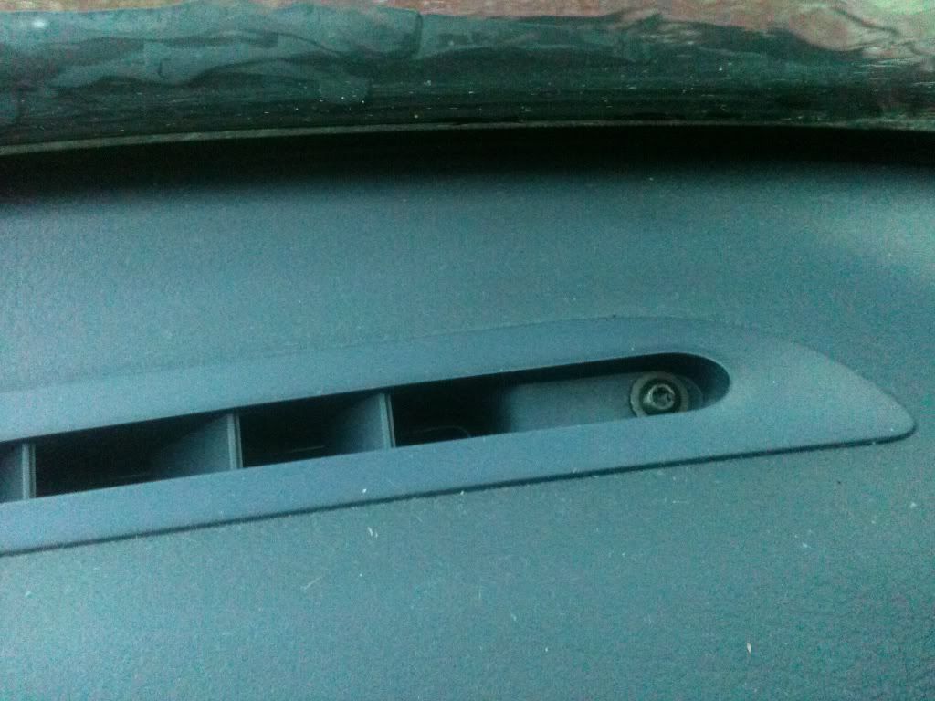

now on each side of the dash there is two small plastic rivet screws, they come out with a torx head bigger than the other screws done so far:
one bit unscrews and then the bit that remains can be easily pulled out of the dash

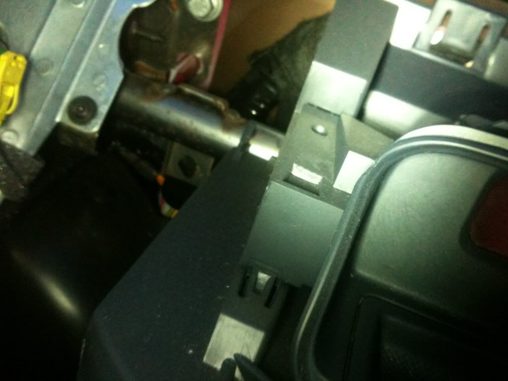

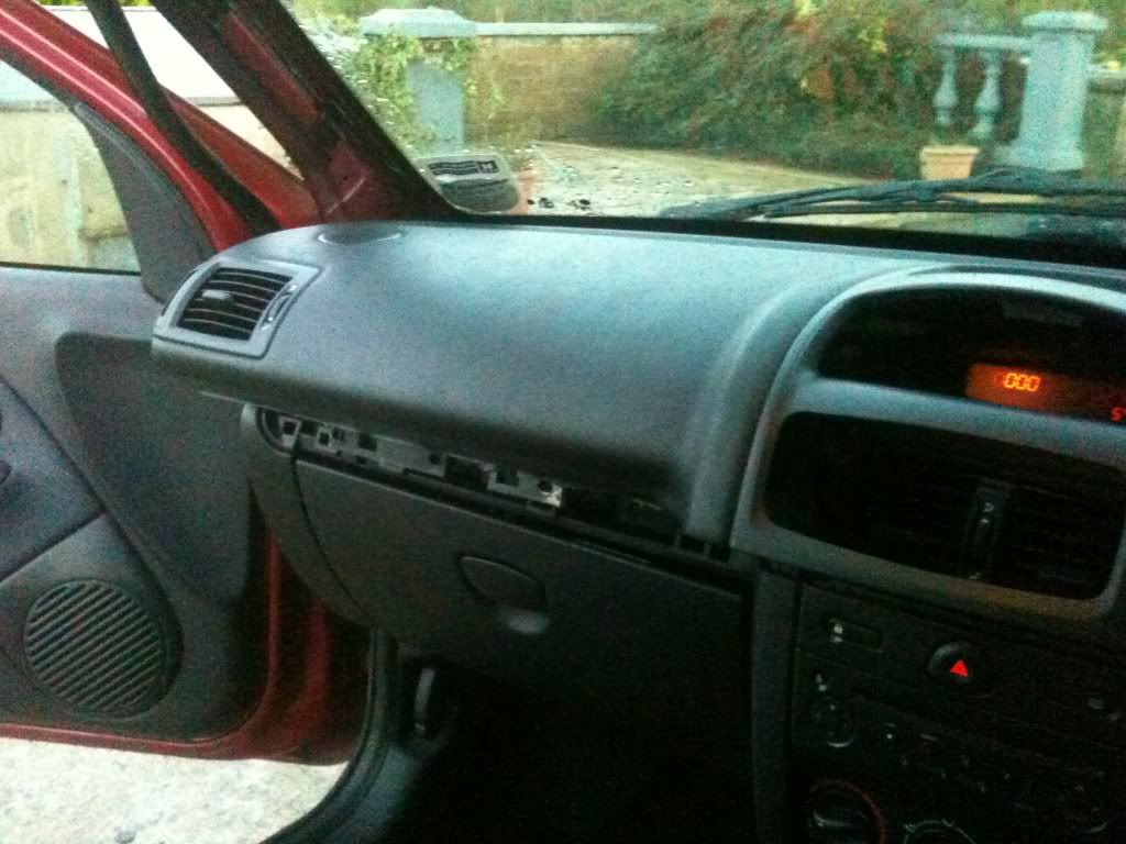

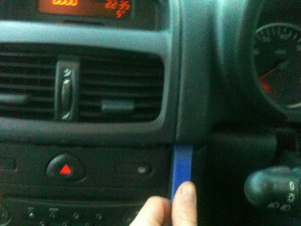

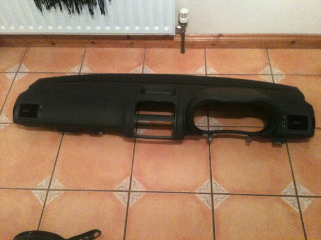

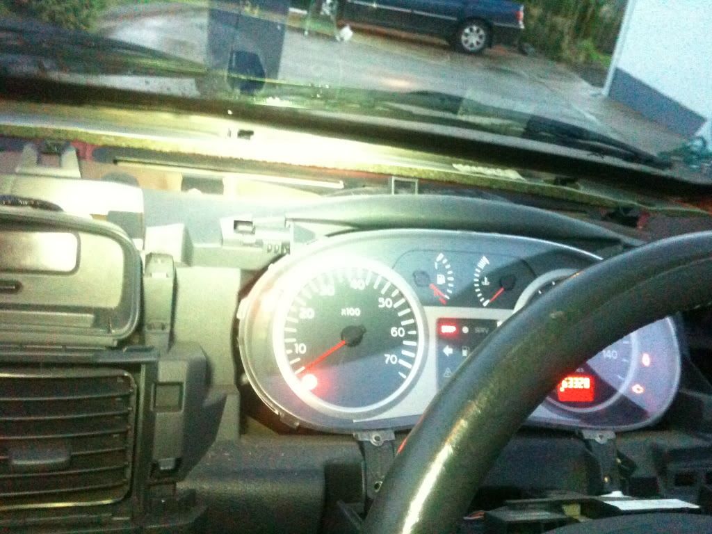

Now all the fittings are out of the way, its just a case of prying and pulling the dash out, above the glovebox needs some prying, a screwdriver is really whats needed:
i put my hand on the windscreen air vent and tried to pull the dash backwards, it seemed the middle part was held in, so placing the pry tool in the gap between the central air vent seemed to release clips:
the tools need to be pressed in quite a bit, but the dash should unclip:

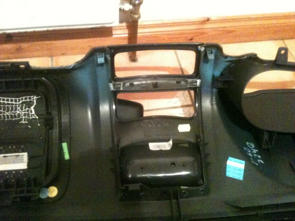

Move the part out of the car, its a bit fiddly, putting the steering wheel down helps, try not to scratch the dash when taking it out and set it down safely while you get the clock out:
them clips on the inside:

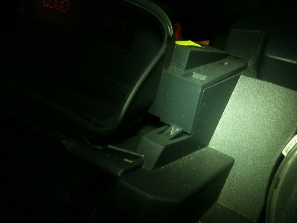

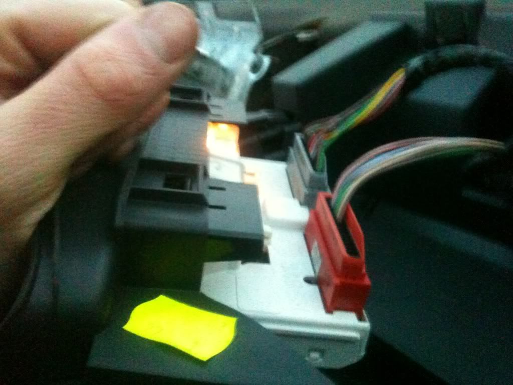

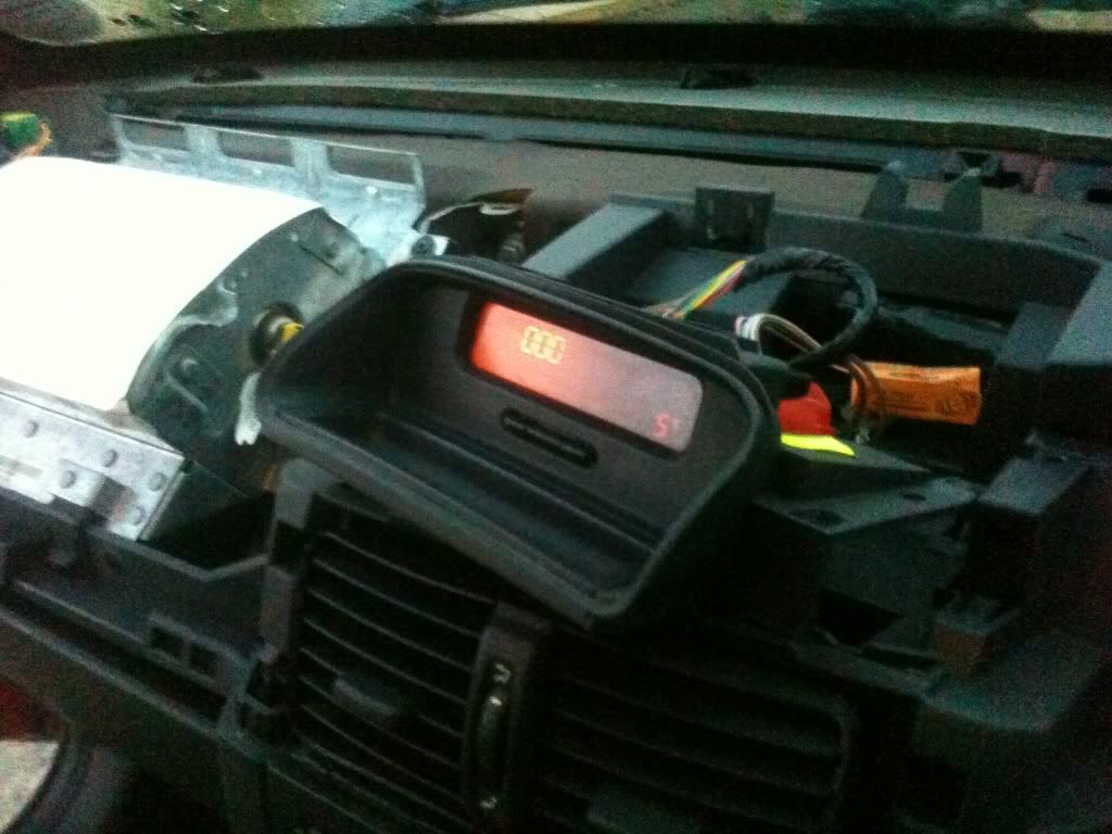

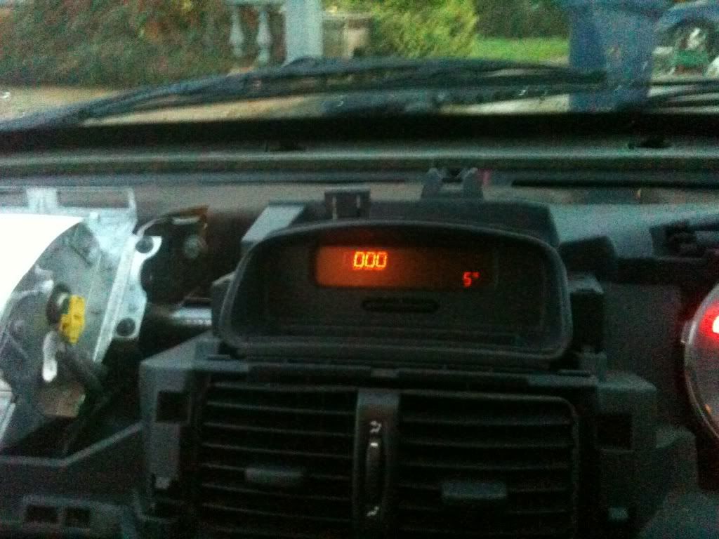

Now its time to remove the MFD, although if your speedo or airbag is at fault they seem easy to get out at this stage:

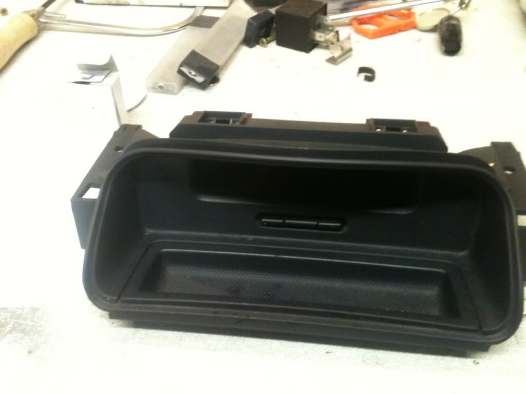

Here is the display, in my car its dim on one side which on a bright day means i can't see the time:
on the left and right of the display are plastic tabs, press down on them and pull the display backwards:
it should now be loose:

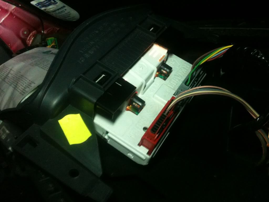

undo the clips at the back, they are them lever type:
The display is now out of the car:
you could probably just change the bulbs with it in the car i just wanted to clean the lcd.

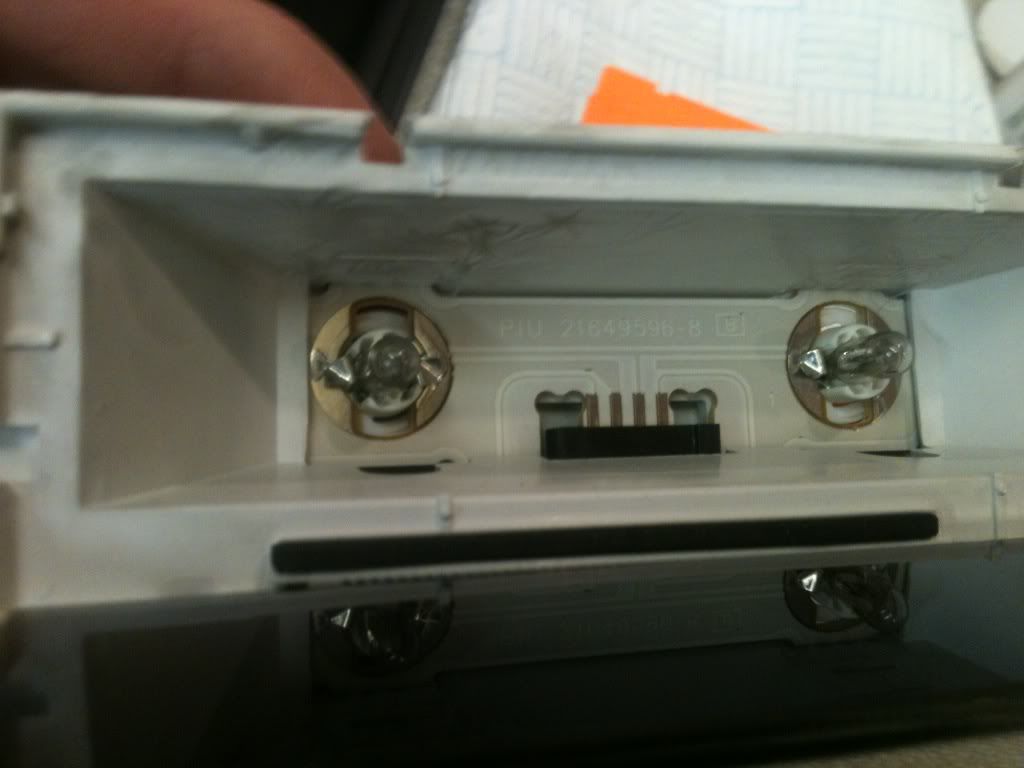

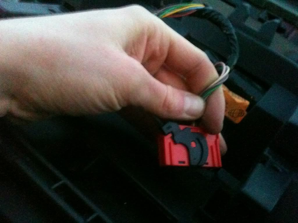

Here are the bulbs at the back they just twist out:

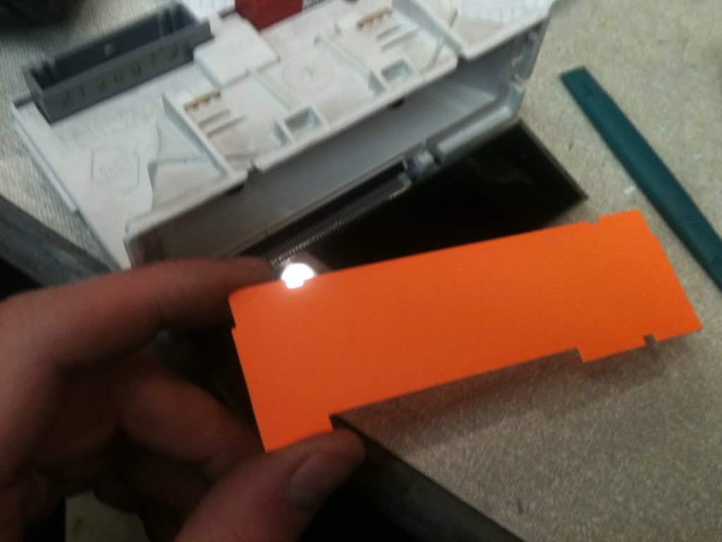

if you disassemble the display here is how the bulbs look like from the front:
the broken bulb:
replacement bulbs are probably available on the internet, but i had a few spare 406 MFD's lying in the attic so i took two of the bulbs from them tested them on the multimeter and put them into the clios display:

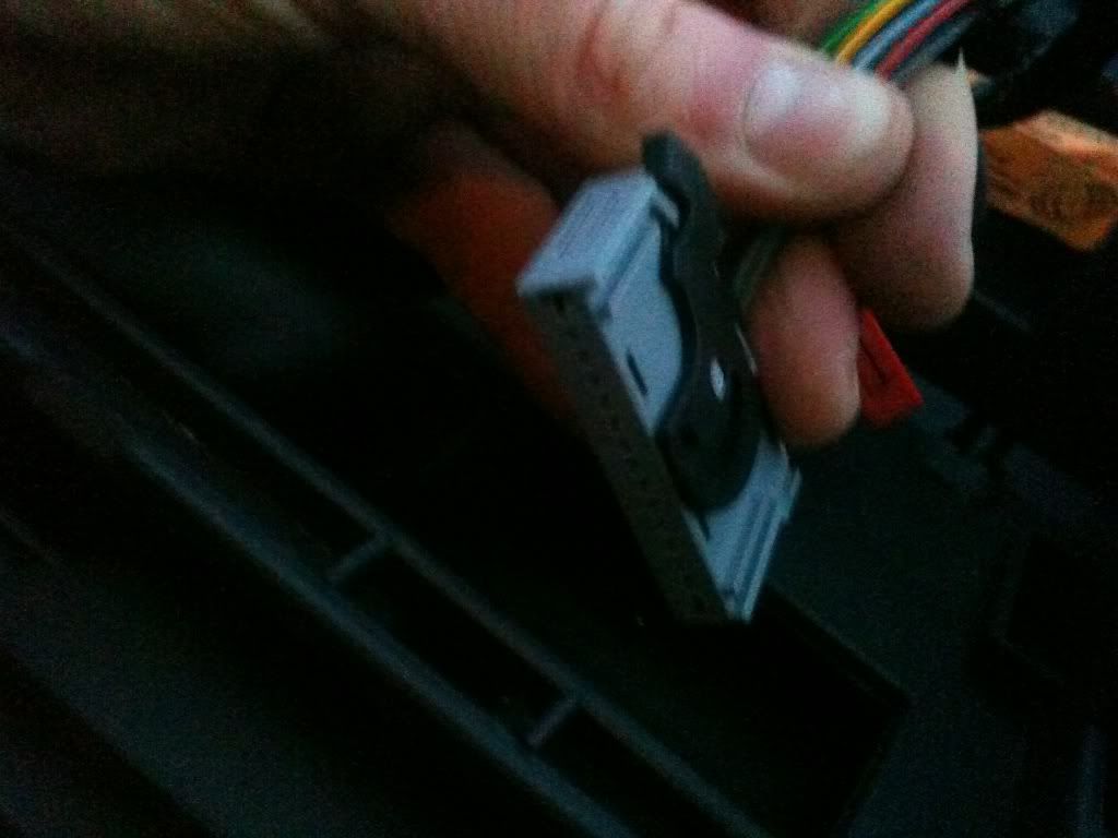

Plug the two wires back into the back of the display, now at this point check if the new bulbs work its easier now than after the dash goes on:
click the display back into place:

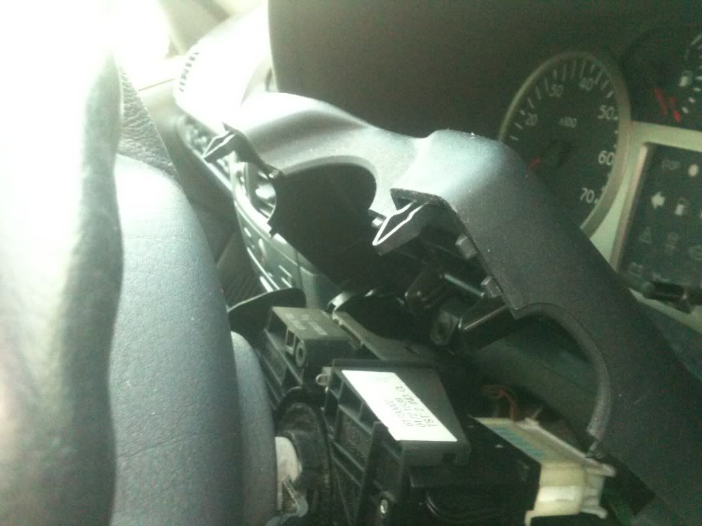

Put the dash back on, its the reverse of removal, although i accidentally broke the plastic bar that goes below the speedometer pressing it past the steering wheel, although its fixed now with some superglue. Its nicer not to break it so its worth watching this part. The central clips press the dash into them i though the dash went down into them but its just straight back.
As for the A pillar trims, they need to be seated properly at the bottom for the door seal to sit right.

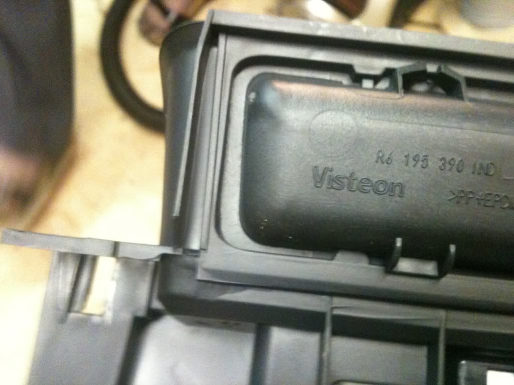

Visteon is a name i do recall seeing on the casing around the display, i always thought they did ford stuff.

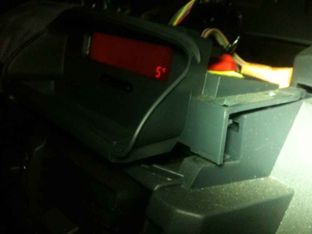

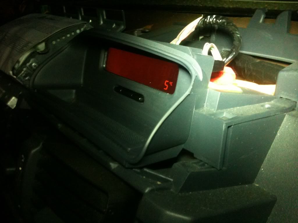

I don't want to have to take my dash apart again but I'm interested in seeing what LED's look like, here is some more pictures of the display setup with the light filter:
if you ever get fed up with orange could these be swapped for a blue one?
And here is the visteon name i seen on the back:

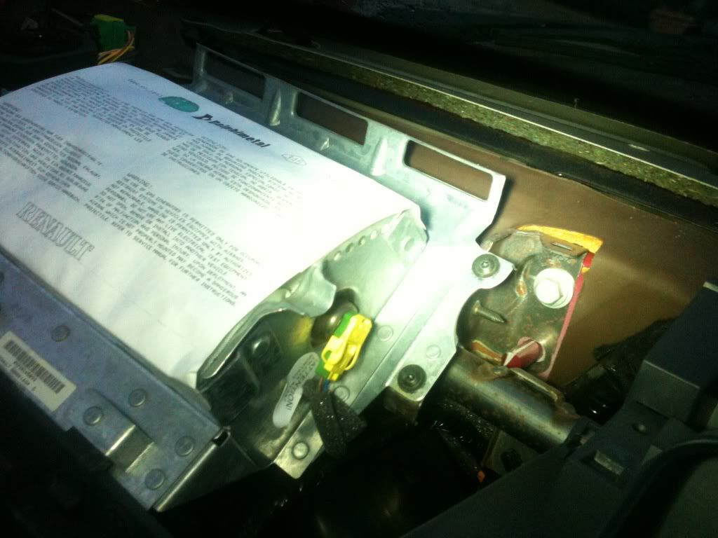

I did this all with the battery still in, the dash top part just lifts off its a big slab of plastic. the airbag itself is mounted to a metal frame below this top.
in the event of a crash the force of the airbag would blow a hole through the dash top where it has been designed to open at.
But no need to take out the battery this doesn't really affect the airbag, although if you do want to take out the airbag, i would advise removing the battery and waiting 30 mins.

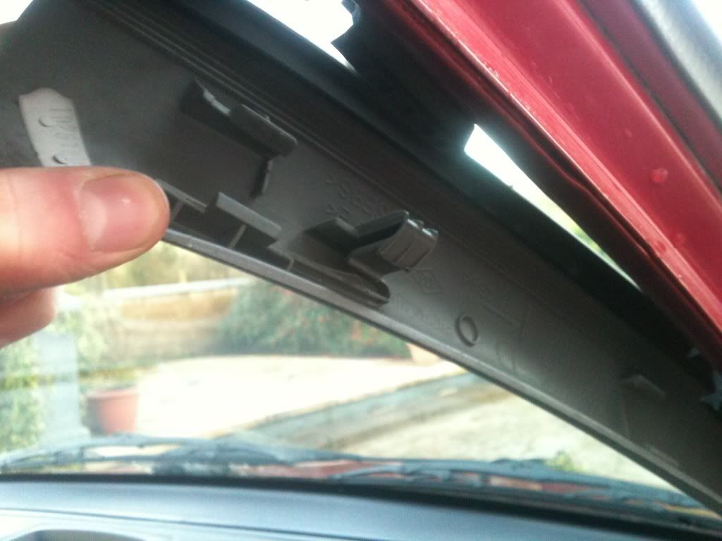

Guys, I have just completed the bulb change in less than two hours including driving to the car spares shop for the bulbs. Here are some notes for people who read this thread in the future along with some pictures, maximum brownie points from the wife :d
1) Thanks to Farmerpug for the video, I loaded it onto my iPhone and played it back in the car, knowing where the screws were saved a lot of time and frustration.
2) The sequence is good, the only comment I would add is that the A-pillar plastic covers have a P-clip arrangement at the top, don't keep pulling at it, simply use a screwdriver to push the P close and it will pop out :confused:
3) If you don't have a flexibly screwdriver for the top of the dash then don't panic, the screws are not in that tightly an adjustable will work fine.
4) I got replacement generic bulbs from my local spares shop (motor factor) for £3 the pair.
5) Note they are not exactly the same as the Visteon originals, Visteon offset the pins. The replacements do work but they are a little loose when fitted, so I measured the distance from metal connection to flange and there was a small difference (about 0.1mm) so I used small pliers to decrease the gap and they are a firm fit. Also the replacements rotate past vertical because they don't have the offset but still make good contact with the PCB inside the unit.
6) An alternative to using the replacement parts is to remove the bulbs from the original part, they are standard wire-ended bulbs. You can take them out the replacement parts and insert them in.
7) Don't work on the car in the cold, it was about 6 Celcuis when I started the job and the plastic dashboard broke as I was trying to get it past the steering wheel. It does not show once re-assembled though.
8) Assembly was MUCH MUCH easier than I had antissipated, the dash goes back into place really easy and all the screws re-align perfectly :cool:
Kindest Regards ... John

Good advice, I'm glad the video helped that was my idea with the video is that its easier to take to the job on a phone or something similar.
Thanks for the bit about the a pillar i just couldn't find the way to describe that clip at the top but you are right it needs pressed inwards.
The flex screwdriver attachment is one option, as is the adjustable wrench way you have used, another would be a 1/4 ratchet with a bits holder.
And the advice about the cold is really important, you have broke it in the same place as i did then, its not noticeable if every things in place, it just seems to snap easy.
Glad it helped, and thanks for your additional advice.

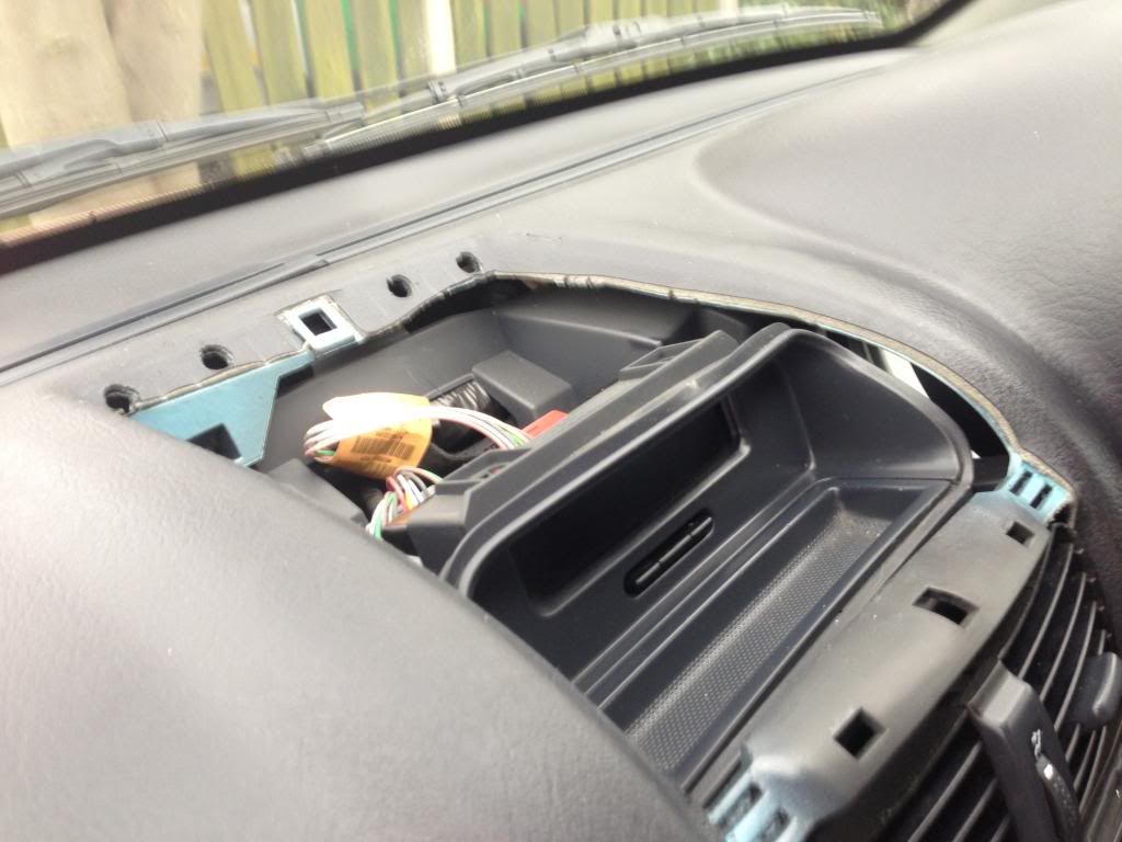

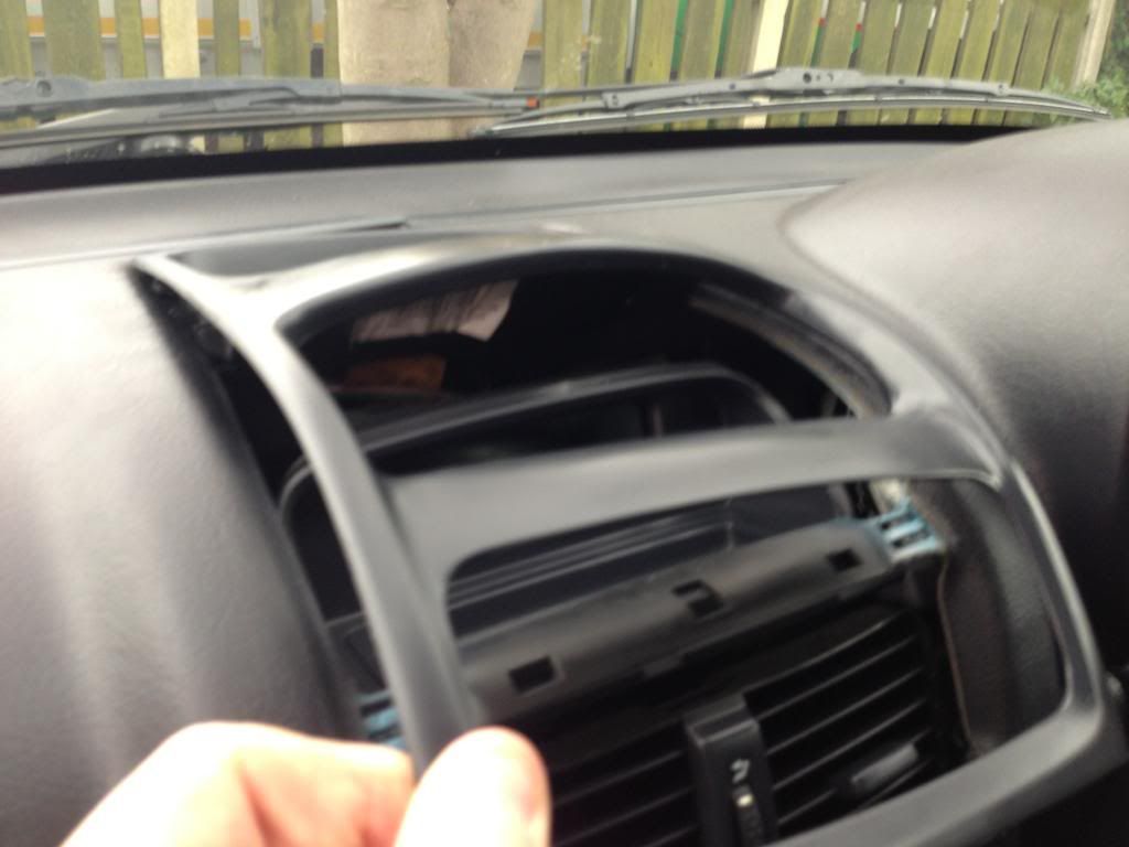

Thanks to Farmerpug for that outstanding tutorial on how to remove the dash. As a followup, I'd just like to say that I needed to change the bulbs today in my partner's 2002 1.2 16v Expression and followed the guide only as far as loosening the dash; it remained more or less in situ.
I discovered at this stage that the section of the dash that covers the display and comes down as far as the middle air vents is merely clipped to the main dash (I say "merely"; it's actually very firmly clipped). With a bit of effort through extremely careful prying, it's possible to loosen this to separate it:
After this, it's simply a case of changing the bulbs as described above (a quarter-turn and pull). It's a little fiddly, as you can't see the bulbs very well, but easy when compared to removing the entire dash:
The only warning I'd give is that it seems as if it would be very easy to break the clips holding this section in place; that I didn't was more down to luck than anything else.
